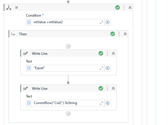

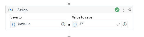

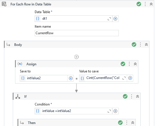

Hie @Preety_Choudhary you mean first int variable value should be equal to column A and then it should be checked with intvar2 ?? if no then i"m sending you a logic …
cheers Happy Automation :grinning:
