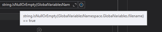

But can someone tell why when assign global variable UiPath freez!
I have a variable want to assign one time! during the process !

have a look at the Data Manager and configure the variable settings e.g. the scope to Global
