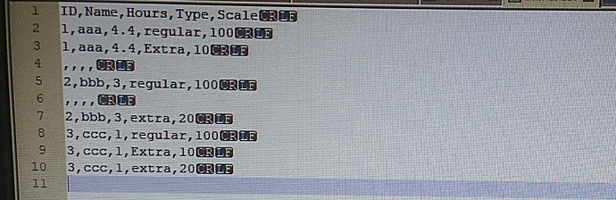

ray_sha
December 4, 2019, 6:54am
14
Hey @Vivek.A.S
I really appreciate your efforts.
The workflow is correct except there’s one additional empty row being included in the output file.
I’ll attach the image below.
Is there a way to rectify this?
Thanks in advance!

ray_sha
December 4, 2019, 9:26am
16
Hey @Vivek.A.S
The output, although not in the same order works well.
Thanks so much for the reply!
Thanks and Cheers!
