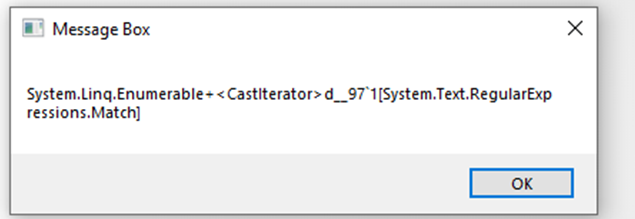

i have used regex to extract value getting diff value pl check below screenshot
@Soni_Reddy1
Matches activity will out List, so you can use For each or if you want always first value only then declare a variable and write as below
MATCHESOUTPUTVARIABLE(0). ToString
Hope this helps you
Thanks
