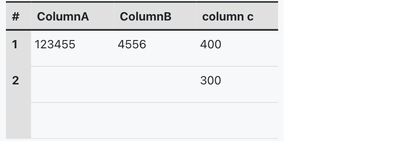

Step1: if datatable has more than one row
Step2: Check in any if the row Column A is empty and column B is empty or colmnn c = variable (holds a value)then remove the particular row
Input
Strvariable=400
Datatable
Column A columnB column c
1222525.     67.         400
400
Output
1222525.     67.          400
              Can you try this once
Datatable.AsEnumerable.where(Function(row) row.ItemArray.All(function(col) not string.IsNullOrEmpty(col.ToString))).CopyToDataTable
              If value is equal 400 then only i need to remove that row
