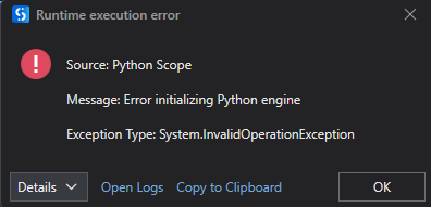

I have requirement to use python scope activity. I have installed python 3.10 and UiPath.python.activities package as 1.8.1 and most recent 1.9.0-alpha as well. It shows the below error.
e
Is there anyway to achieve this in 32-bit? If yes Please mention required versions.

As per error if you install any version •less than 3.10 then 32 bit is supported else you need to install 64 bit

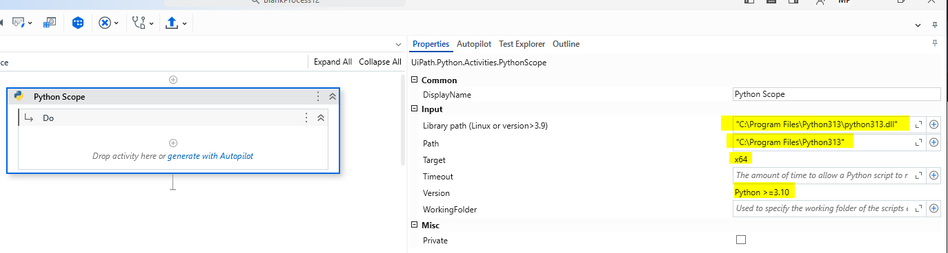

Use UiPath.Python.Activities.1.10.0
Configure the Python Scope as below:
Library path: "C:\Users\your_username\AppData\Local\Programs\Python\Python311\python311.dll"
Path: "C:\Users\your_username\AppData\Local\Programs\Python\Python311"
Target: x64
Version: Python >=3.10
In below case is for Python.3.13.3 and it worked.
