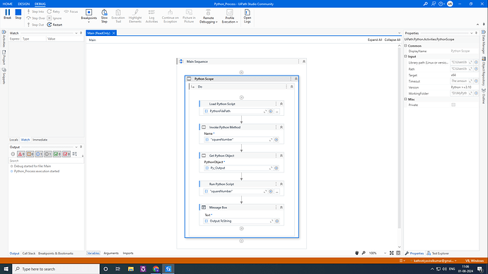

Python scope activity properties not set. How to set and how to run python script just "Hello Python". please help me."
I already mentioned screenshot in the mention already.

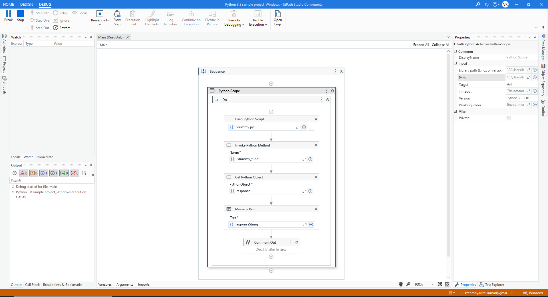

Can you try the below xaml
Python.zip (79.2 KB)

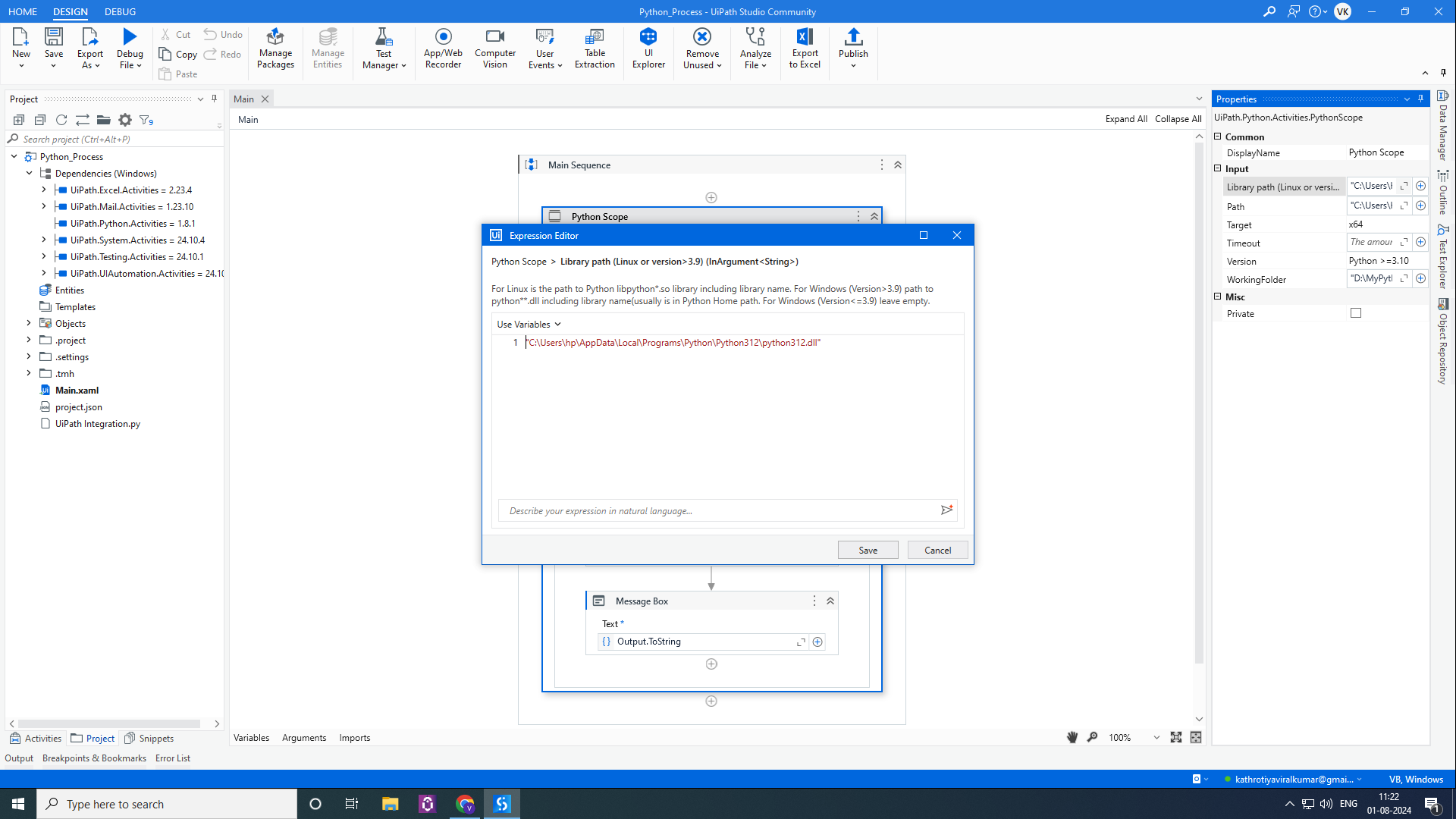

It’s stuck, Path does change after stuck.
@viralkumar_kathrotiya,
Your Python version is beyond 3.12 Downgrade it to 3.12 or less
Once done then, check if you have installed .NetRuntime 6.0 from here.

Now 10.8 installed. But still facing same issue.
Ok what about the .Net Runtime?
Dot Net version is above 6
Install .NET Runtime 6.0.32 specifically and retry.
