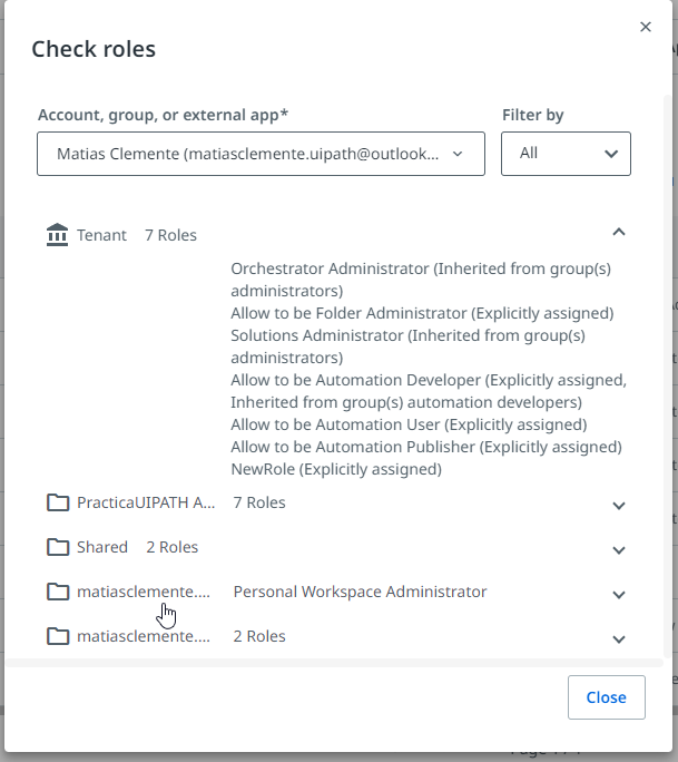

“Before starting this question, I was doing many tests. Since I couldn’t manage to publish it, I deleted all the users and all the machines I had created, and also deleted the folders. Perhaps I deleted something extra, and now I can’t publish it. However, I checked the Publisher role, and apparently, it’s assigned. I’ll paste a screenshot.”

@Matias_Clemente.Arg
You need to edit user and selector automation developer under same manage access
Edit the machine and check what license is given on second pge

I don’t know if I did what you were asking me to do. Assign the “Robot” role to both users
