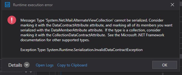

error
I limited the scope of the variables but got this runtime error. Can you explain please?
Yes. In order for a process to be able to suspend, all variables need to be serializable. You probably have some variable that is not serializable.
The reason for this requirement is that the robot must be able to save its state so that on resume it can pick up where it left off .
