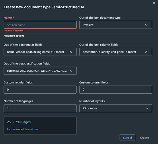

Try to create Semi-structure AI and use invoice as out of the box document type.
There is info how many document is recommended for specific number of languages, fields and layouts.
Use this tool to train the pre-built invoice model from UiPath on your documents

This semi-structured AI is an extraction method used when you create new document type.
(Go to document understanding tab in orchestrator, create new project and select new document type with option ‘using semi-structured AI’). You can choose one of existing pre-trained model (e.g. for invoices) or select custom document type. It is possible to define additional custom fields or columns. This tool is good for strengthening UiPath pre-built models on your specific layouts
