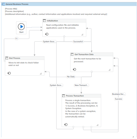

The reframework is made like this
So after folder one processed it is moved to archive and it is going to the initial state but it is not picking the “22.02.2024” folder instead it is picking the same folder which is already processed and moved to archive that is “21.02.2024”.

@Gokul_Murali
  1. After successful processing of first it should go to get transaction data…if it is going to itialize means there might be some failure
  2. Show you get transaction data as that is where you would set the transactionitem and your transaction item should be set properly for it to work
cheers
I have changed the REframework condition in the end process.
So after completing the first folder it will come to the end process and move the processed folder to archive.
Then again it will go to the init state to check whether there is any folder to process or not if folder exist it will read the excel from that folder in the init state and should proceed.
So transition T1 will pointed to init state so after first folder it will goto the init state again to check folder any other folder exist or not
@Gokul_Murali
What is the condition that you have given?
and if you loop this way where did you give the end condition
cheers
In T1 transition - If transaction item is nothing it should goto init state and is going to the init state as per the given condition.
But the issue is that when coming to init state after processing the first folder it should take the second folder, instead of that it is taking the first folder again.
To end the process i have given a condition in the end process itself
That is if there is no folder available for process it should terminate
@Gokul_Murali
What is the condition you are using in init state to say that it should take second folder now
and if transation item itself is null then what are you using?
why are you trying to complicate it…when you already have the available loop for you
the only thign you need to do is…change transactionitem to string to assign the required path and in init state if first run use directory.GetDirectories("BaseFolder") and save it to a list of string variable
then in get transactiondata use if condition with in_transactionnumber <= listvar.Count then out_transactionitem = listvar(in_transactionnumber-1) on else sisde assign with nothing
cheers
