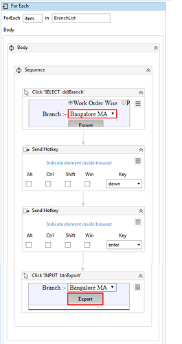

Hi.
I am selecting item from a list to download report one at a time as per selected item…however if report doesn’t contain record , it gives pop up saying “no record found”.
Now i have use the ContinueOnError property to true in my click to select activity, however it’s not working…Please help
@peachnam,
Try try catch activity, it works for you.
Could you please explain step by step? as i am new to UiPath. Which activity to use in Try Catch and what to do?
Hi, the steps in the for each loop to download report is as shown in image.
I tried using “element exists” and then send hotkey to close the pop up, however, now the loop is keeping on selecting the same item in the list for which there is no record pop up window comes up…please help with the steps for Try Catch
