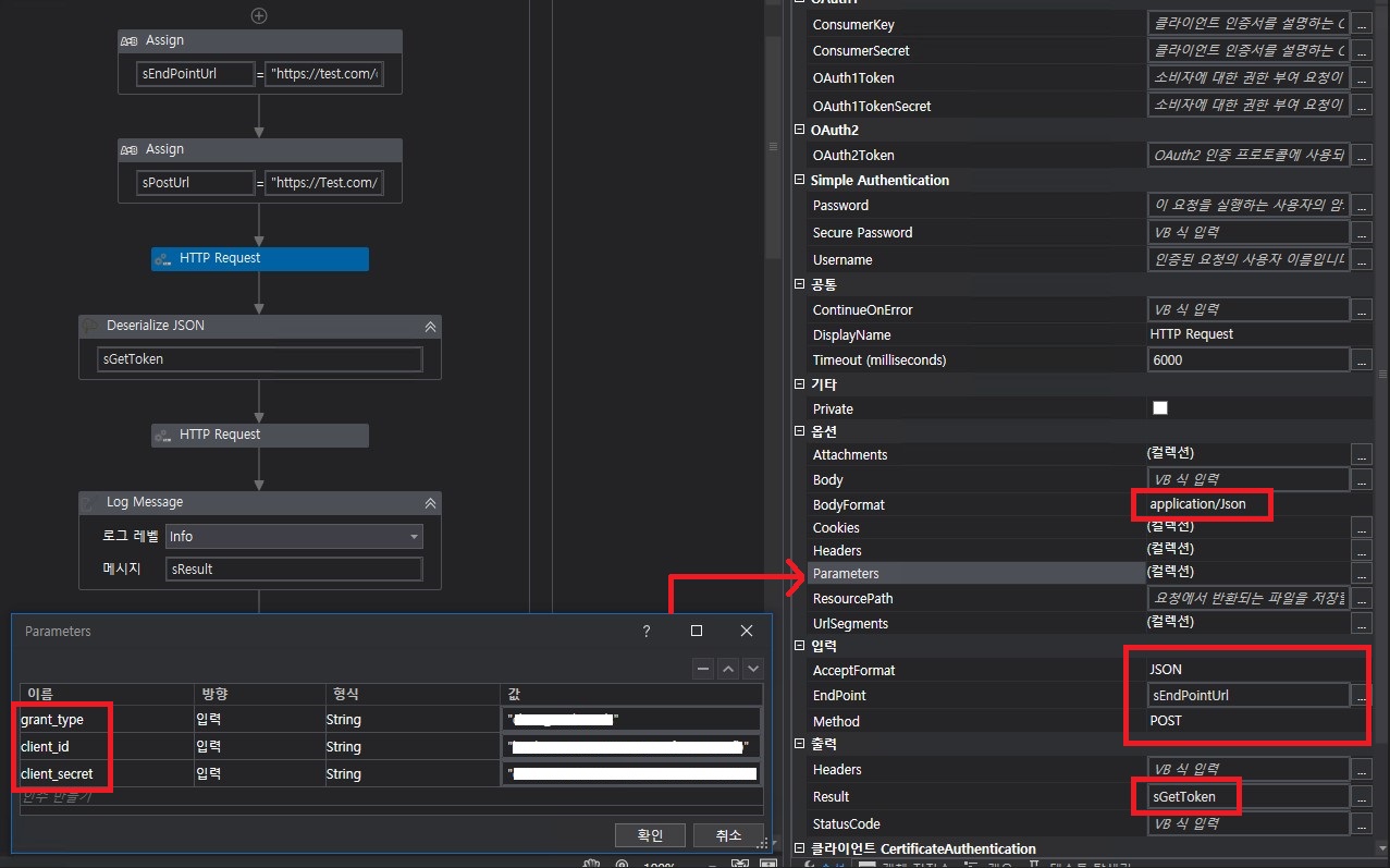

I don’t have much knowledge about Get/Post, so my questions are sloppy, but I would appreciate your help.
The current logic configuration is as follows.
(The data contained in the variable is randomly created, and the actual data is separate.)
Getting a token from the first http request will proceed normally.
Please refer to the picture below.
Then use the Descriptiveize JSON activity
The token information was included in the jObject variable.
And there is an error in the part where we proceed with the second http request.
I would appreciate it if you could tell me which part I’m typing wrong.
Nothing is entered except the part shown in the screenshot.
The errors that occur are as follows.

As I said above, tokens are being delivered normally.
I corrected it according to the method you told me, but the same error is still being printed. In the second http request, can you tell me what values should go into the Headers and Parameters of the option?
