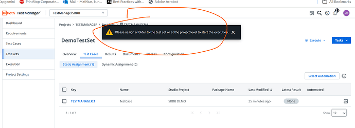

I have add test set to test mnaager and getting below error while executing
help me on same to resolve the issue.

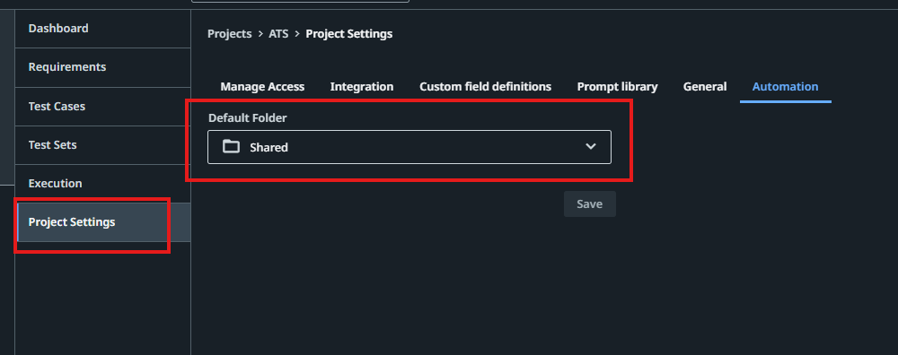

Go to project setting >>> Select folder where test cases are published and will be executed

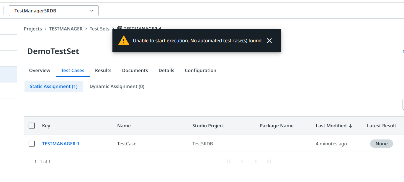

that issue resolved but below is comming

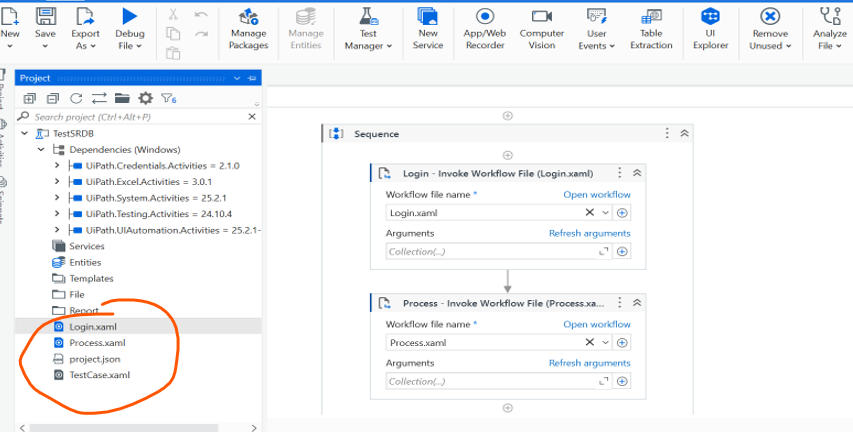

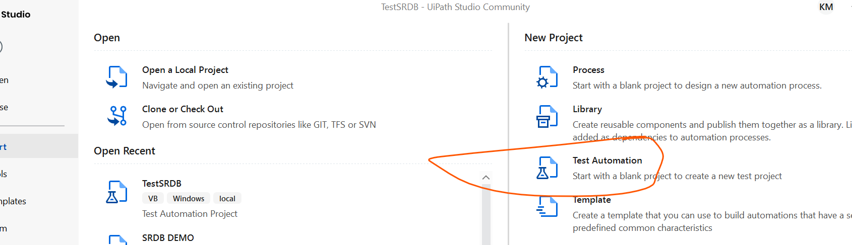

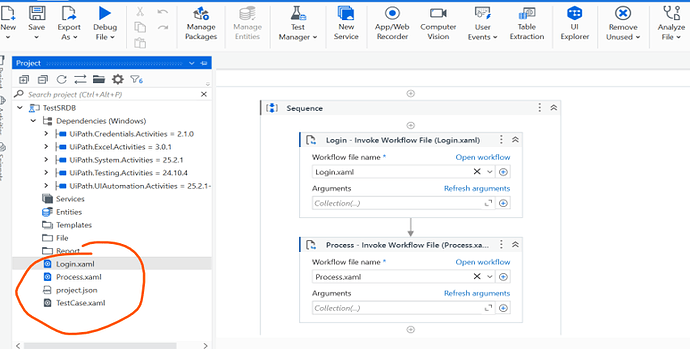

i heard somewhere we need to create workflow using Test Automation
so created and updated my old file and converted them to test case
so they look like below
what is te issuenow.
help me on same

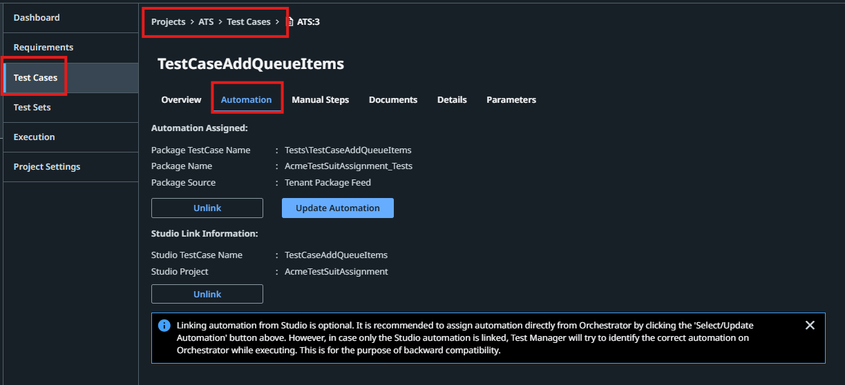

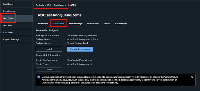

@Mathkar_kunal did you published them? if yes
can you check if automation workflow is linked or not by below steps
go to test cases >>> open test case >>> go to automations >>> link the project and test case
thanks it worked.

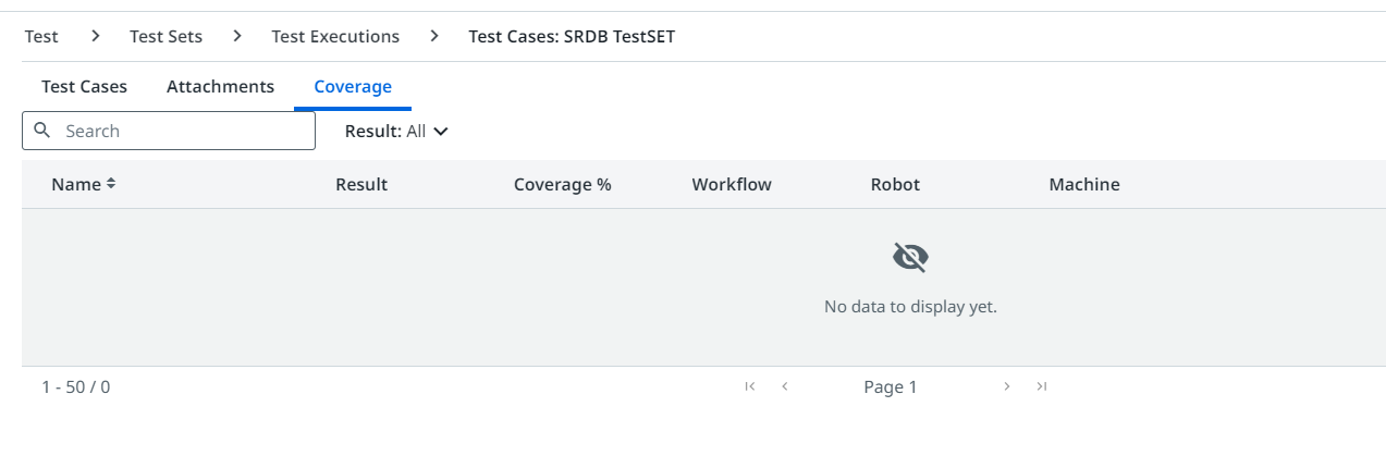

just on emore question why there is no dat in coverage section . i have execute d test set from testing as well
Sometimes, there might be a delay in processing and displaying the data. It might take a while for the results to appear. Wait for sometime…
yes i waited but there was no data
@Mathkar_kunal can you check now?
you can see below ss
![image|690x278](upload://kceoAZQizSBe9lgPCM4l34l9B6S.p
it not loading also for coverage.
test case status is there but coverage not there

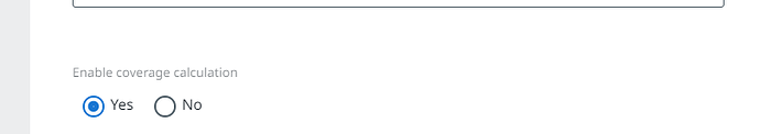

Hi @Mathkar_kunal
You need to enable it for the required Test set. Kindly refer the below snapshot:
it is already enabled i can see

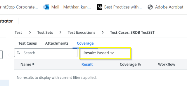

@Mathkar_kunal
Remove the Coverage filter:
If you have enabled the Coverage recently, then it will work after next execution.
