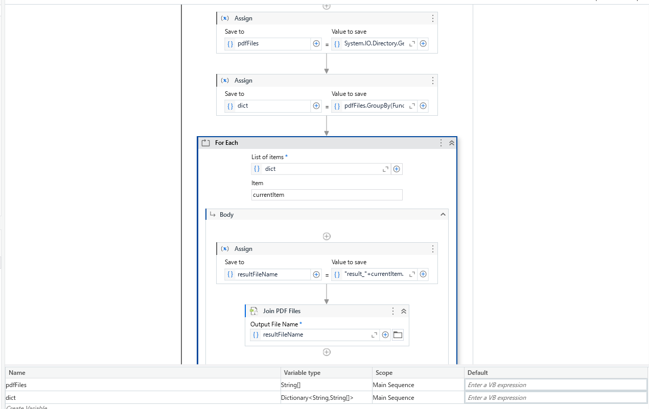

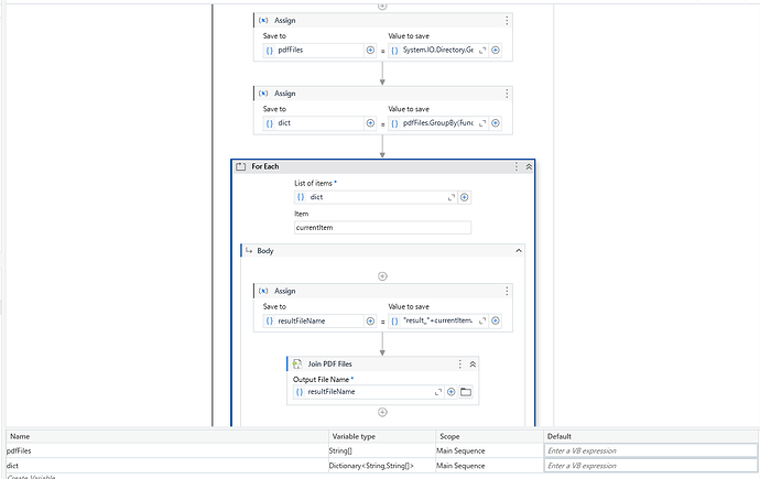

HI,
Can you try the following?
 dict = pdfFiles.GroupBy(Function(f) System.Text.RegularExpressions.Regex.Match(System.IO.Path.GetFileNameWithoutExtension(f),"^[A-Za-z]{4}\d{2}-\d{6}" ).Value).ToDictionary(Function(g) g.Key,Function(g) g.ToArray)
Sample
Sample20231212-1.zip (176.2 KB)
Hi Yoichi,
Thanks for the solution, Its works for me.
