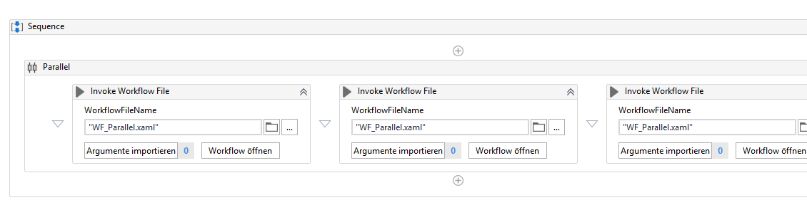

I wan’t to have multiple chrome browser instances to be processed at the same time / need to run in parallel. Therefore the construction is like “Parallel”-activity on top level and multiple “Invoke Workflow File”-activities within. What I found here in the forums, the use of Parallel and Invoke Workflow File should lead to concurrent workflow processing detached from main thread. Also to mention: the workflows process the same URLs.

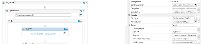

This works to some extend. But the workflows seem to interfere each other, which may be… don’t know the case because they process the same URLs and therefore selectors may be found also in one of the other chrome windows. This happens although each Workflow File opens it’s own Browser Window and all the Clicks and Set Texts are within this Open Browser activity.
The question maybe, is there a way to make sure each workflow-instance only targets the browser-instance it opened itself? I think it should be possible if there is way to have them remember the browser.

That was something I tried. But when having “Open Browser” create output UiElement myBrowser and having it referenced in “Click”-activity this throws something like “You have specified Element and Selector as inputs. You are supposed to input just one of them”. But how then to reach the button on the website?
Your Click Activity should be inside the Attach/Use Browser activity so it uses that activity’s scope (the desired browser window). Then the selector for the Click will just be the specific page element.

thank you very much. The problematic activities all run within the Open Browser activity… therefore I can not understand the problem in post #1 at all.
With the Click activity inside the open browser, you don’t specify the input Element (myBrowser). You only use that in FUTURE “Attach Browser” activities.
You’re running the same thing three times so each one is overwriting the value of that variable when it opens.
Using Parallel to run the same thing three times at the same time is always going to cause problems.
It was just the same file 3 times to have it easier to set up for showing. Imagine different workflow-files but they are partly manipulation the same web-adresses. That means at runtime there is a chance that a selector is only unique to the Browser instance started by the workflow itself.
