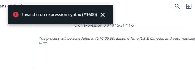

Hi,it’s showing invalid cron Expression
0 10 15-31 * 1-5
@yashashwini2322
would you be able to share the error screenshot?
Please find the attached image
@yashashwini2322
both days of month and day of week together in one cron is not supported

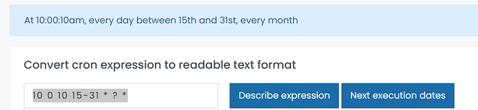

what you can do is create a calendar in orch…and mark all sunday and saturday as holiday and use below cron and select the created calendar so that it runs only after 15 of month and as calendar says sunday and saturday are holiday will skip those
10 0 10 15-31 * ? *
you can build cron on this site
This. Use a cron expression generator, copy the output string, and click “Advanced” in the Orchestrator trigger to paste the expression.
