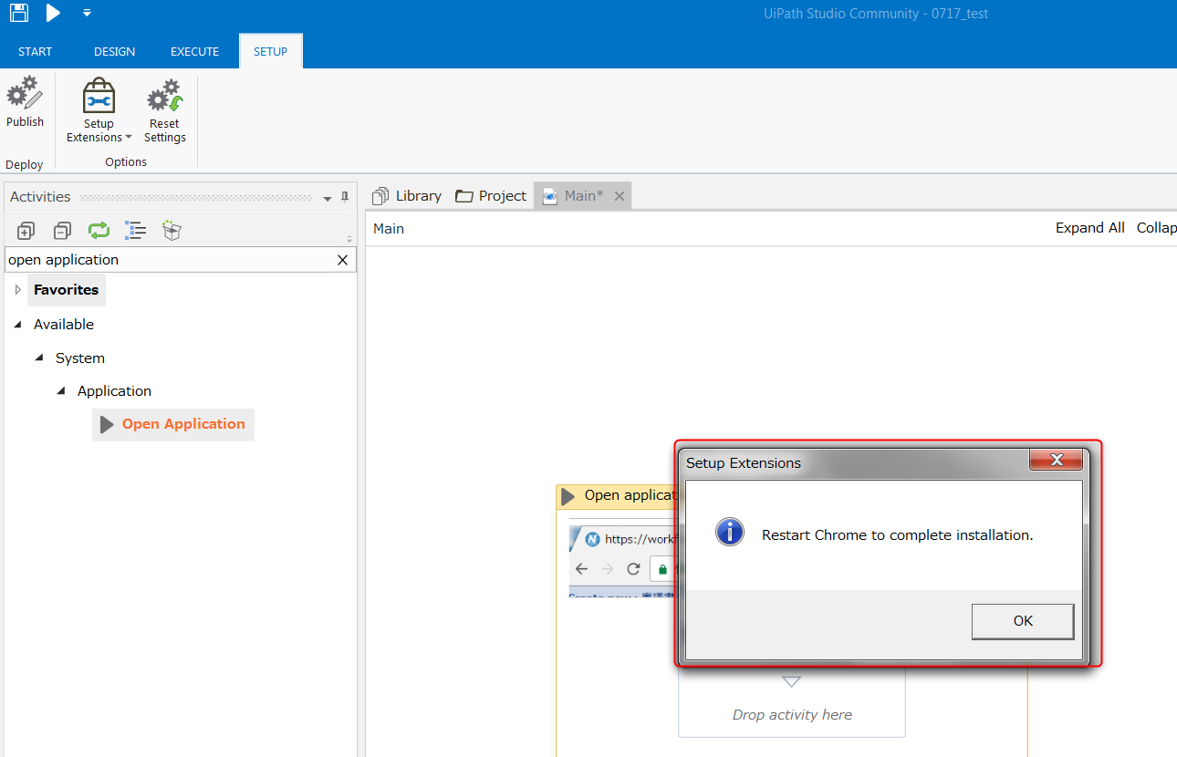

I have solved by this method in the chrome,may be useful.:grinning:

I clicked this but screen was displayed as belows.
