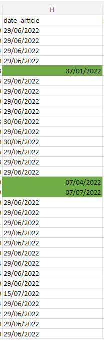

Hello everyone. I have a column in excel that I transform into a Data Table.
My dates are in formats : dd/MM/yyyy
Others (in green) are in MM/dd/yyyy format
I would like to convert these dates (in green) to dd/MM/yyyy format. Here is my flow:

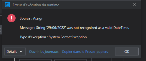

Here is the error I get

Data in green cell seems datetime type in excel. If so, the following ForEachExcelRow might help you.
Condition
CurrentRow("date_article").RawValueType =Type.GetType("System.DateTime")
Then
CurrentRow("date_article") = CDate(CurrentRow("date_article").ToString).ToString("dd/MM/yyyy")
Hello, thank you for your answer. I tried this however I can’t make my condition, I have this error:
Compiler errors encountered while processing expression CurrentRow(“date_article”).RawValueType =Type.GetType(“System.DateTime”).(2) error BC30574 Option Strict On reject all late bindings
