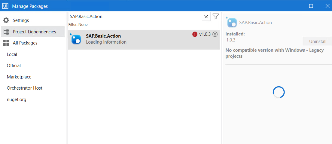

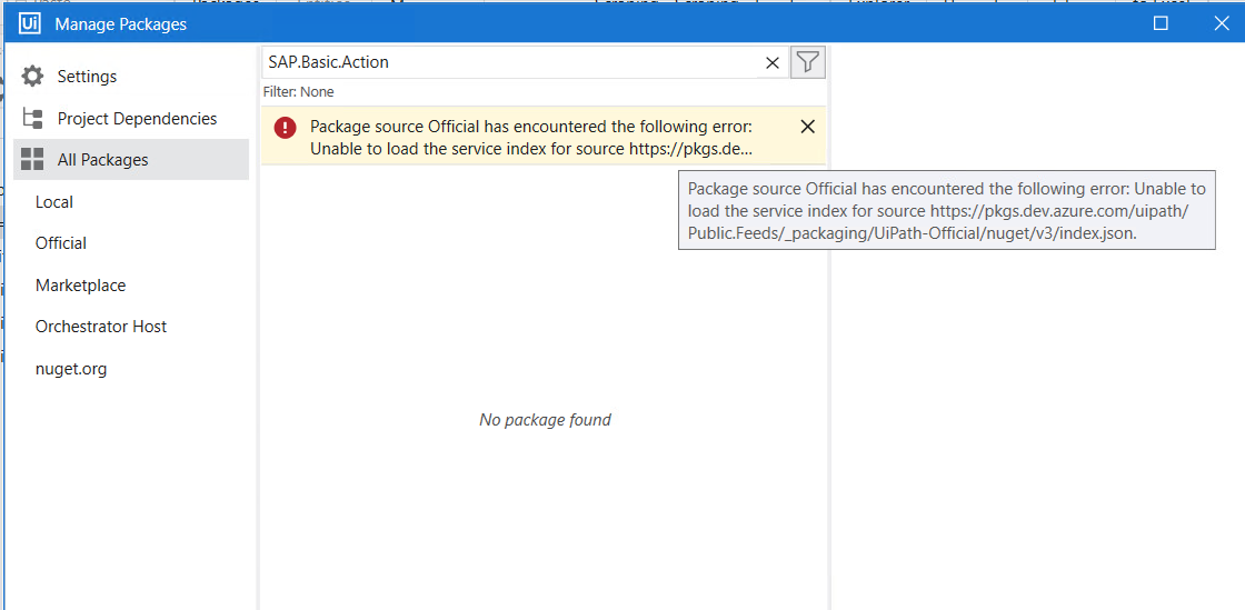

I don’t find the package with this name in nuget. If it’s your internal package try to load it with local option.
Also Issue is with package compatibility. Your project seems Windows - Legacy in which the current version is not compatible.
You can either try older version of the package or if possible change the project version to Windows (non legacy)

SAP.Basic.Action is not a package in any of the public feeds, so it sugests its a library you built yourself.
In the first screenshot it seems the library is made in legacy and so logically cannot be used in a non-legacy project.
In the second, it cannot be found but I don’t know where you published it. Is the first one locally published? If its in the Orchestrator feed it should be visible.

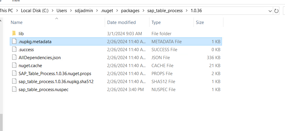

It is in the same folder of the development.
Sowjanya.S
Screenshot? Libraries don’t go in folders like that, they go in feeds.
So that means it got it from a feed and its been installed on the machine. You don’t manage nuget packages in the folders manually.
