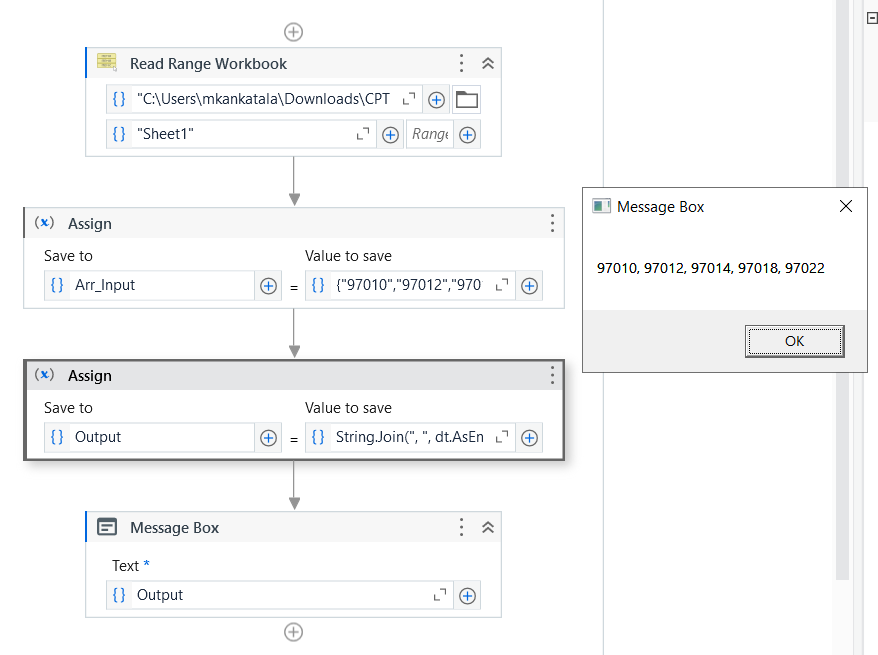

Okay @Nikhil_Katta
Then you want the output in String right, check the below,
→ Use the assign activity and create a Array of String datatype variable called Arr_Input to store the input numbers in a variable.
- Assign -> Arr_Input = {"97010","97012","97014","97018","97022"}
→ Use the Read range workbook activity to read the excel and store in a datatable called dt.
→ Use the Assign activity to write the linQ Expression to check the condition and to take the matched input and create a String datatype variable called Output to store the output.
- Assign -> Output = String.Join(", ", dt.AsEnumerable().Select(Function(row) row("CPTCODES").ToString()).Where(Function(code) Arr_Input.Contains(code)) .Distinct().ToArray())
Check the below output for better understanding,
Hope it helps!!
