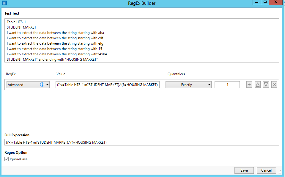

am able to extract the data using read PDF activity with range. now i need to extract the some part of data in extracted output - i found using regex we can get that value. as am new to development and tried with several regex patters but not luck - will you be able help me by forming the regex pattern.
I want to extract the data between the string starting with “Table HTS-1
STUDENT MARKET” and ending with “HOUSING MARKET”
eg:
Table HTS-1
STUDENT MARKET
HOUSING MARKET.

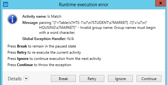

Hi @JaganR
try this!!
(?<Table/s?HTS-1\s?\n?STUDENT\s?MARKET) .?(?=\s?\n?HOUSING\s?MARKET)
Let me know if its not working…
Hi @Sriram07.
Getting this error
@Sriram07 - Have added = sign before Table and now am not getting that error - Thanks
(?<=Table/s?HTS-1\s?\n?STUDENT\s?MARKET) .?(?=\s?\n?HOUSING\s?MARKET)

assign var=system.text.regularexpressions.regex.match(test,pattern,regexoptions.singleline) .tostring
here,
test is a string variable contains your text
pattern is also a string var with value “(?<=Table HTS-1\n?STUDENT MARKET).*(?=HOUSING MARKET)”

Hello Sriram, Thanks for your followup - but am not able to get the required output with above pattern.
