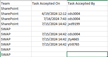

Input: I have a excel input which contains with different teams
Example:
output: should be in another sheet with their counts
