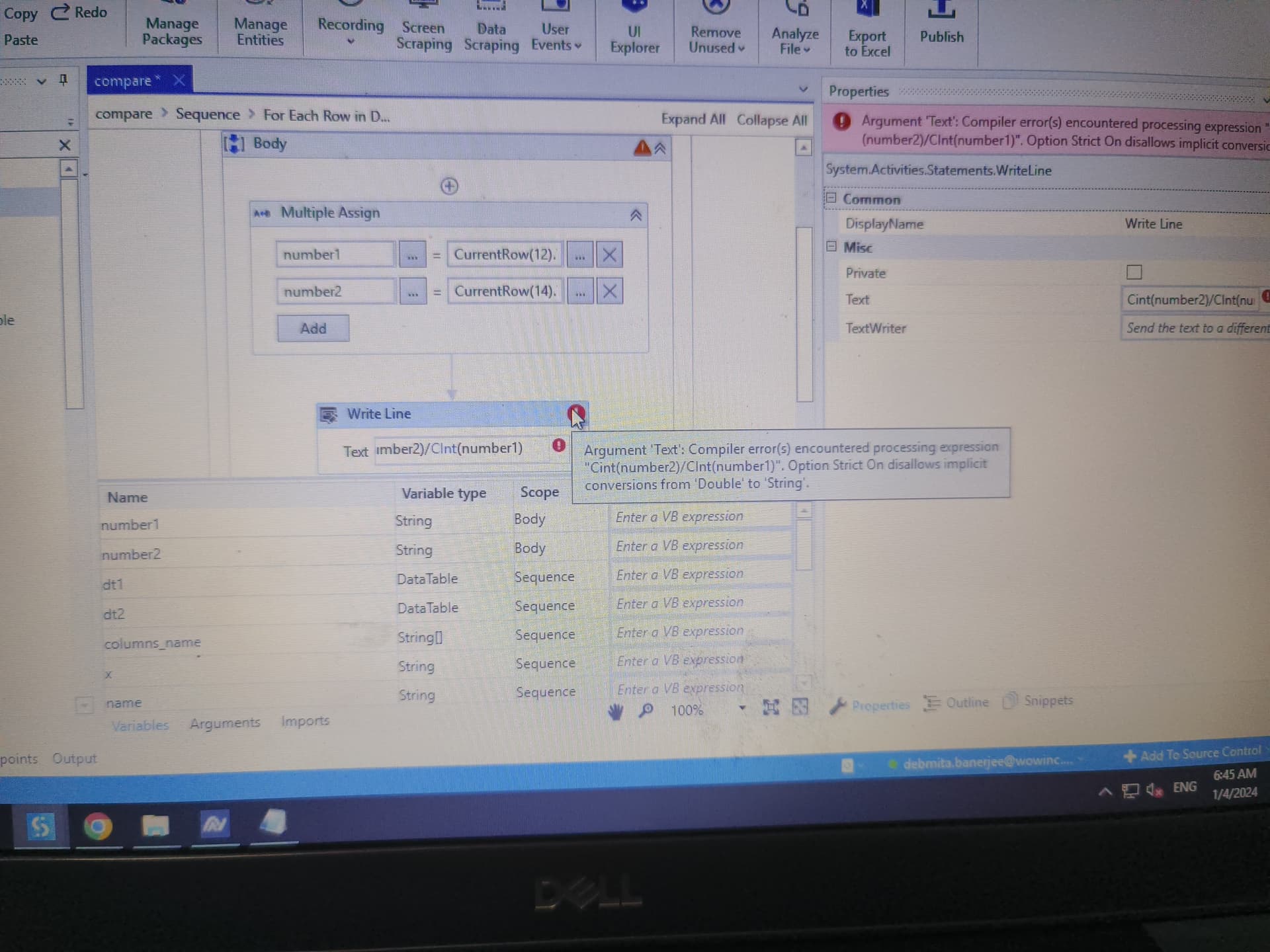

Thank you for helping me, ya it’s true but if I just want to divide the value in row 1 under column3 with column5 then can that be done?

Thank you so much, just one more doubt how do I do the division as I am getting compiler error, sorry for asking this stupid question

Try the below syntax in Write Line.
(CDbl(Number2)/CDbl(Number1)).ToString

Hi I am able to calculate two columns that I got as an input from notepad but not sure how to extract the output to a new CSV as an additional column as write CSV is pasting the last record only
