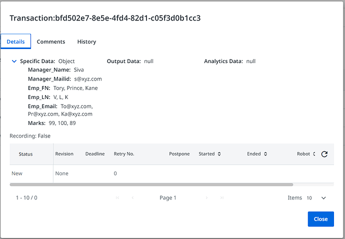

i have manager list whose belongs some of emp fn and ls with marks and mail id i need to add those items into queue
can you give me solution for that.
Input queue item sample,
Upload queue item sample,
I need to add the queue items can you give me solution for above one.

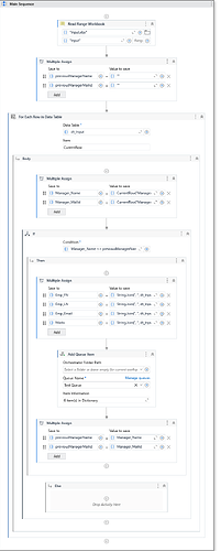

Hi @Vicky_K
Input:
BlankProcess17.zip (58.8 KB)
Queue Items will added like below:
If you have any questions, please let me know I will help you out.

@Vicky_K
You can try this way and this is the simplest way
dt.AsEnumerable.GroupBy(Function(a) a(0).ToString).Select(Function(a) a.CopyToDataTable).toarray
ForumQueueItems.zip (10.4 KB)
