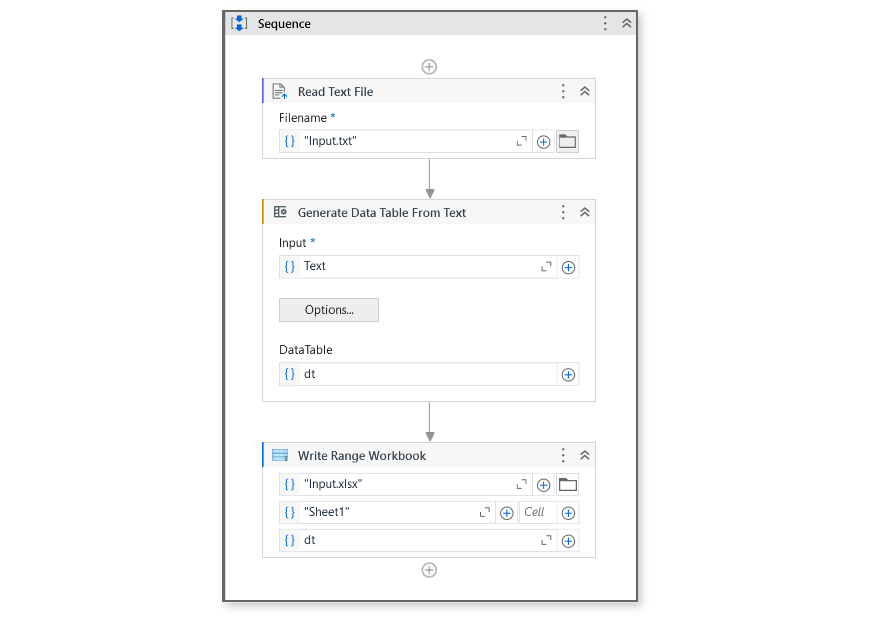

Hi @rakeshcm456
You can use Generate Data Table From Text activity to convert the string to datatable. If possible share the expected output. will help you with flow.
Input:
Workflow:
Output:

How about the following sample?
Sample
Sample20240328-4.zip (2.7 KB)
