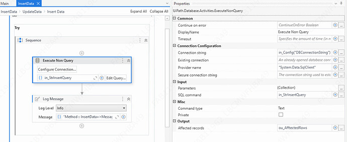

If you are using RE Framework. Kindly follow below steps to make your code standard
  1. Create reusable workflows first under Database Folder as below
  1. Each workflow should have activities corresponding to their purpose. Example in Insert Data. Hope you are aware about the connection and the queries to be used.
  1. Note that the insert data should happen from the Dispatcher process. Ideally Dispatcher and Performer should be 2 different process and RE is mainly for the performer.
Dispatcher - Process which add records to queue. When you add to queue - add to DB also as a next step with Initial Status as 0 using queue reference
Performer - Getting queue items and processing one after other
-------------------------------Pre-requisite’s ready -----------------------------------
  1. From the performer - Inside Process transaction State → Inside Process.Xaml
Invoke UpdateData.xaml and pass the query inside to update the transaction and make the Initial Status as 1 using queue reference
  1. In case of Technical Error / Business exception, It will be in the catch block of Process. Note Process should be within try catch. Based on the type of excpetion - Before throwing error , Update the DB with status as 3 using queue reference and give comments as well invoking UpdateData xaml file
  1. At the end of process without going to any catch block → Update the DB with status as 2 using queue reference and the same invoke code with different value in the query
the above will give a framework idea. You can improvise on top of this
Hope it helps. Happy Automation
