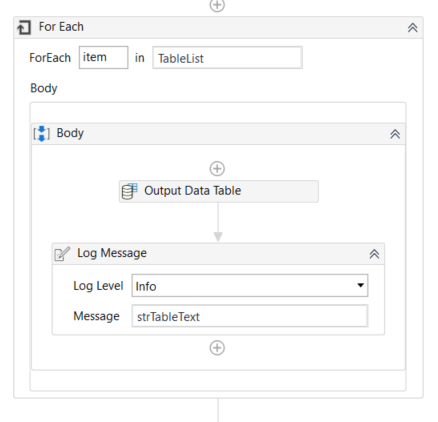

I get an error whith output datadable:
ppr
(Peter Preuss)
February 1, 2021, 10:55am
12
@nina.wenner
lets asume you are trying the loop from above then you will use item (the current datatable of the loop)
