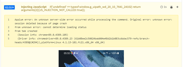

I tried Manage Other App Activity, but that didn’t help. So, I checked the logs in BrowserStack and it shows that page got crash after Bot clicks on Login button and control is expected to be back to App.
That app works fine if i test it using app live feature, so it doesn’t seem to be an issue with app.
But i am not sure if this is an issue with Browserstack or UiPath MDM.
Also, I was debugging the flow multiple times, so out of 10 times, it worked once when app didn’t crash, without any changes, kind of confusing. Thanks
It seems to be an incompatibility between the chromedriver used by Appium and the actual chrome version installed, but I’m not sure what you can do in this situation. If the Appium instance is run locally then there is an option to force the use of a custom chromedriver, but in this case I’m not sure if browserstack allows something similar.
One idea that comes to mind is to try the same but on an older device (say Samsung Galaxy S20) or on an emulator. That device might have an older Chrome that is compatible with Appium chromedriver.
