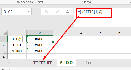

I need to move and overwrite a worksheet, from one excel to another, but when I carry out this movement, the target worksheet loses the formula references, follow the vba code that I am using.
Before Copy:
After Copy:
As you can see, the target worksheet lost the formula reference of the “TOGETHER” sheet, to solve this I tried to disable the automatic calculation before copying the sheets, but without success: Here’s the VBACode:
