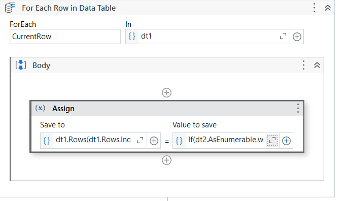

Hi @taruna.mehra
U can use this expression inside For each datarow activity instead of using old one.
step 1: drag foreach row in datarow activity
Step:2
drag Assign Activity and use this expression
Left side:
dt1.Rows(dt1.Rows.IndexOf(CurrentRow))("Column_BU")=
Right side:
If(dt2.AsEnumerable.where(Function(x) x("Column_J").ToString.Equals(CurrentRow("Column_A").ToString)).count>0,
	If(Not String.IsNullOrWhiteSpace(CurrentRow("Column_BU").tostring),CurrentRow("Column_BU").ToString,"NIL"),CurrentRow("Column_BU").ToString)
Thank you
