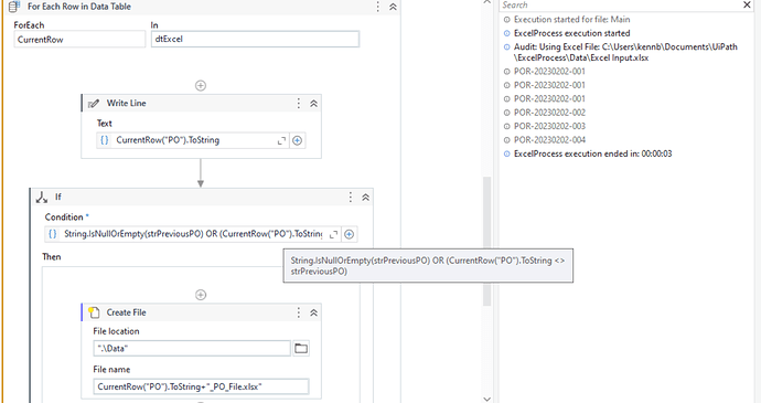

hi @anh.nguyen
You can try this:
Hope this helps. Happy automation!
Kind regards,
Kenneth
