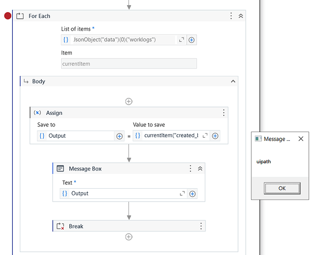

Okay @anjasing
Follow the below step by step process,
→ Take Read text file activity to read the text file and store in a String datatype variable. Output → Input_Str.
→ Use the Deserialize JSON activity
Input → Input_Str (string datataype)
Output → JsonObject
→ Use for each activity and give the below one
JsonObject("data")(0)("worklogs")
→ Inside for each insert the assign activity to store the value.
- Assign -> Output = currentItem("created_by")
→ After assign activity insert break activity to break the loop.
Output -
Hope it helps!!

Thank you soooo much for such a detailed explanation. It worked. :slight_smile:
