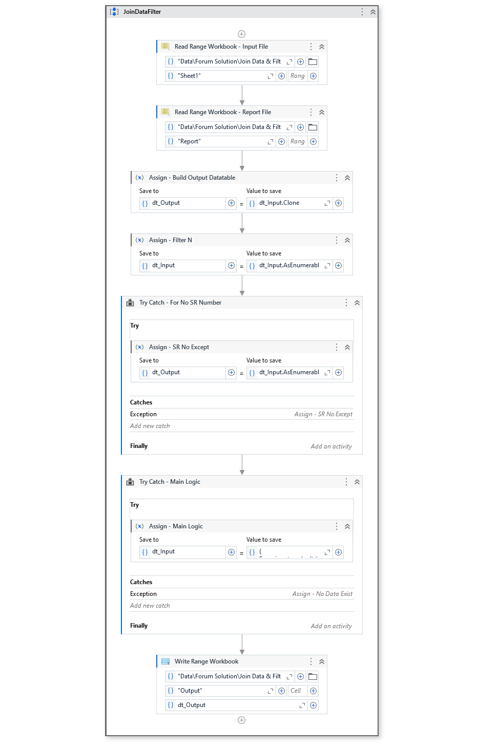

@Stef_99 Ya Sure! I have started working on it!
Hey @Stef_99
Got the Solution!
For Building Output Datatable:
dt_Output = dt_Input.Clone

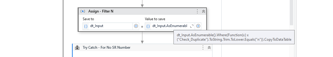

For Filtering Check Duplicate with “N”
dt_Input = dt_Input.AsEnumerable().Where(Function(x) x("Check_Duplicate").ToString.Trim.ToLower.Equals("n")).CopyToDataTable
If No SR Number Not found:
dt_Output = dt_Input.AsEnumerable().ExceptBy(dt_Report.AsEnumerable().Select(Function(r) r("sr1").ToString),Function(r) r("SR").ToString).CopyToDataTable

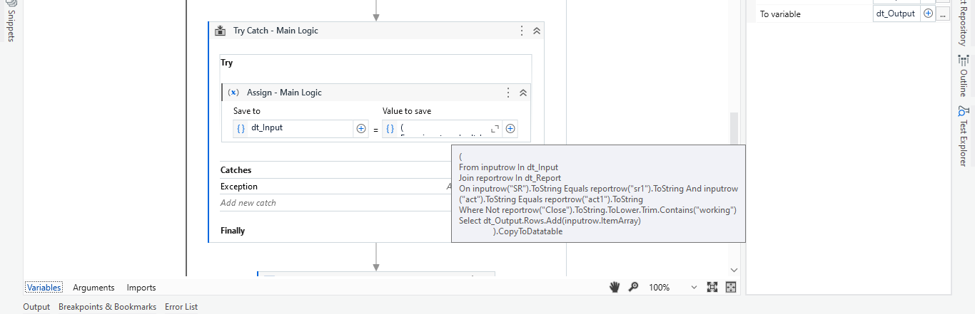

For Main Logic:
dt_Input = (
From inputrow In dt_Input
Join reportrow In dt_Report
On inputrow("SR").ToString Equals reportrow("sr1").ToString And inputrow("act").ToString Equals reportrow("act1").ToString
Where Not reportrow("Close").ToString.ToLower.Trim.Contains("working")
Select dt_Output.Rows.Add(inputrow.ItemArray)
	).CopyToDatatable
Note: I have surrounded LinQ with Try catch Actvity for Exception Handling. For scenario like No data row generated!(No Output)
Attaching .xaml for your reference!
JoinDataFilter.xaml (12.9 KB)
Just execute the .xaml
You will get the expected Output!

@Ajay_Mishra I have a question
If output write dt_output only.
Why you check in try catch main logic variable dt_input
But not use dt_input in data that write in excel output.
@Stef_99 Good Question!
As you can see in Main Logic LinQ we are adding Rows in dt_Output datatable. So the final output will be stored in dt_Output!
But if there will be no rows after filteration of Main logic then assign activity will throw an error and to handle that I have surrounded it with Try Catch block! and at the end no output will be generated in this situation.
If you got expected output, just mark the above post as solution!
It will help others to find the correct solution.
