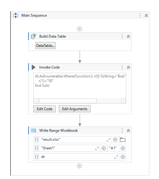

HI,
The following sample will help you.
dt.AsEnumerable.Where(Function(r) r(0).ToString="Bob").ToList.ForEach(Sub(r)
    r(1)="50"
End Sub)
Sample
Sample20231003-4L.zip (2.8 KB)
