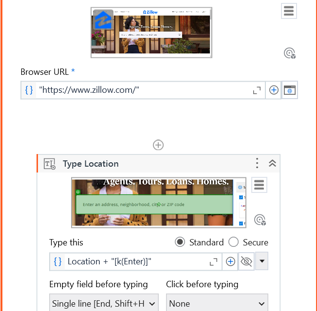

i am attempting this web data scraping project from Udemy. first i placed the input dialog and then after placing the name of a city, UiPath then places the city onto the search bar at zillow.com and then goes to the next page. It doesn’t do that. instead it just stays at the home page and at the end of the URL, i got a question mark. any ideas of what my discrepancy is?

Hope u have the sequence of activities like this
  1. Input dialog box
  2. Get the input and save it in a stringvariable
  3. Use application browser activity
  4. Inside that use a type into activity and pass the string variable obtained earlier
Cheers @Smit_Jain
Hello,
Yes. Exact same order as you listed and still i keep getting that peculiar issue. no idea why.
You may disregard now. i found another way. it turns out my program couldnt accept the keyboard shortcut so i added another click method to click on the search box and now my project is working without any fail.
