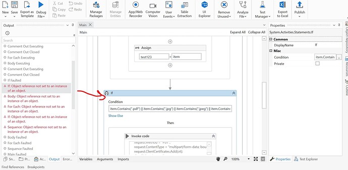

hello @Yoichi @Konrad_Mierzwa at the same project whrn I do debug, now it’s giving me this error. How to solve it please?
It seems item variable is null. Can you check content of the item when error occurs?
If it’s null, can you try to add !string.IsNullOrEmpty as the following?
!string.IsNullOrEmpty(item) && ( item.Contains(".png") || item.Contains(".jpg") || ..........)
OR, if there is an expression behind the visible expression, please share it as text.
And as the above question is apart from title of this topic, perhaps you should create new topic because it will help those who face same issue.
