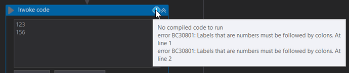

Here is a terrible example (just wanted an error warning to appear)
Invoke Code - Set to VB.NET
So the line numbers match the Warning.
