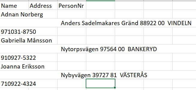

I have successfully scraped the data but when I try to insert it to the excel file all the data ends up under the first column. But I want the scraped variable “name” to end up under column Name, variable “address” under column Address etc…
How it looks now:
How do I assign the specific data to each column?

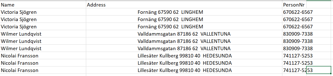

I did however come up on another problem after that… Now it inserts triple of the value:
I tried to change the number of iterations on the while loop that scrapes the web site but its still 3 inserts even if I change it. I tried to move the Write Range outside the For Each and the While loop but it still inserts 3 of each values…
After some investigation I see that the ArrayRow is the problem. I changed the Assign arrInfo to only {name, address} which changed the insert number to only two but didn’t fill in the PersonNo column of course…
Any suggestions to what the ArrayRow should be to solve this?

Yes I know! But i get triplets of data when I use {name, address, personNo}, duplicates when i only use {name, address}.
I only want 1 of each person.

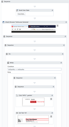

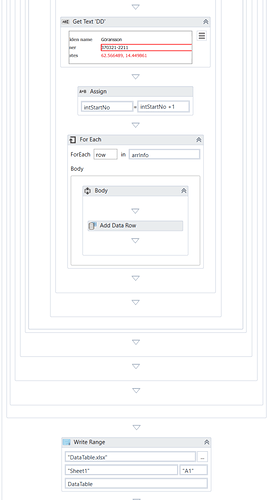

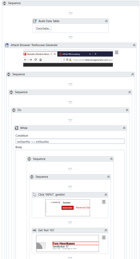

Here is a full picture of my sequence :

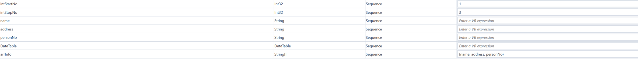

May i know what is the value of that variable arrinfo in for each loop at last
Cheers @goerris
The value is {name, address, personNo}, the variables of the scraping of type String.
@Palaniyappan
No no
The one in for each activity
Like
For each row in arrinfo
So in that what is the value of arrinfo
Cheers @goerris
That is the value! It’s probably wrong I know…
Sorry if I’m misunderstanding
@Palaniyappan
Check out the images I posted below your response.
Pasted the whole sequence and the variables I’m using.
Thank you
@aksh1yadav
Got it
This will resolve the issue now

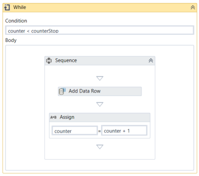

—For variable arrinfo change the type in the variable panel as just int32 and default value as 1
—now in the sequence instead of for each loop use a while loop activity and in the condition mention like this
Counter > arrinfo
Where the Counter is a variable or type int32 defined in the variable panel with default value as 0
now Inside the while loop have
—Add datarow as we have now
—Assign activity like this
Counter = Counter + 1
The reason we were having three elements in the array so the loop was iterating for theee times and that why we were getting triplets of value in our datatable

This works, almost…
Now it only adds one person instead…
It only adds the first person that the scraper scrapes in the while loop and the other ones doesn’t get inserted.

ScrapeToExcel.xaml (14.8 KB)
@Palaniyappan
Hey @goerris
Sorry was on some urgent call :slight_smile:
Try this out -
ScrapeToExcel.xaml (16.6 KB)
Regards…!!
Aksh
Wow! Thank you!
All you had to do was just skip the for each! :smile:
Cheers! @aksh1yadav
Hey @goerris
Yes and Dealy is also playing a role because once you will click on Generate button . webpage takes time to load new data so if you wont use delay then it will scrap the same old user data.
Regards…!!
