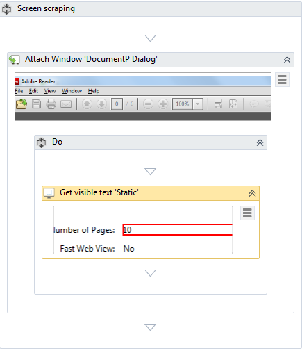

No man, I set “0” as default to string variable2 and assign a number using screem scraping → get visible text
Put a WriteLine just before it and see if it actually scrapes a number (screenshot would be nice as well, so we can help better).
Basically I’m getting the number of pages of a PDF file, so, I send CTRL + D with a HotKey Element then I use Screem Scraping and inside I use Get Visible Text and in the selector property use Attach to a live element…
but I realize sometimes the bot get the number of pages but other times don’t.
Exist a better way to get the number of pages of a PDF File?
Here I assign the number of pages in this case variable2.
If you put variable2.ToString in WriteLine, what’s the output?
I solved the bug, The problem was the screen scraping, The element was not capturing the information correctly.
Thank you all.
