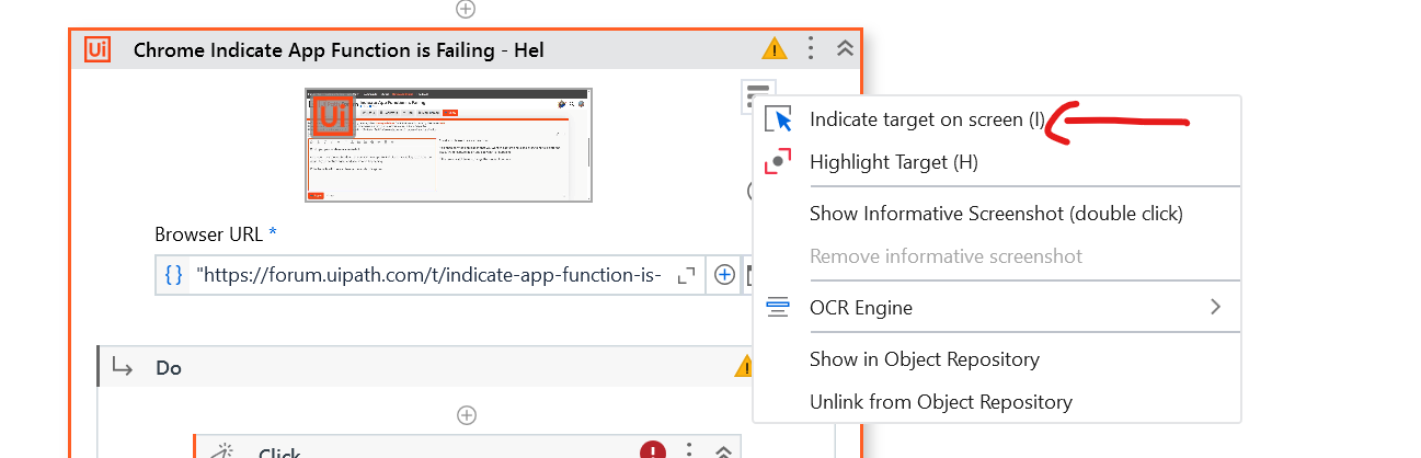

I am using Use Application/Browser Activity.
I hit indicate application and it appears UiPath Studio just isn’t recognizing the app window that is open. I see the green indicator show up in the corner of the window (not the usual highlighting the app window itself), when I hit it it takes the location of an unrelated Windows app. I am on the latest version of Studio.

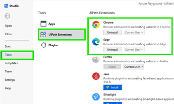

If you are indicating the browser, and it shoes yellowish, Then You need to enable the UiPath extension for that browser.
Make sure to install it first:

All browsers are enabled. I tried a browser and then tried Notepad and other applications just to see if it was a browser related issue.
