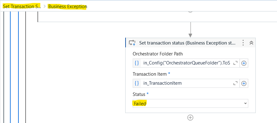

If Transaction item got business exception in RE Frameworks, it will set the status as failed, no need to make any changes in the code.
You can check the below image or Go to Process Transaction state → Open Set Transaction status workflow → Open the Business Exception sequence → In the Set Transaction status sequence you can check the Set Transaction status activity which set status to Failed.
Hope it helps!!
