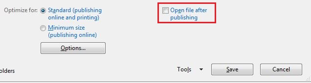

Hello @Dhanushree,
Fantastic… you get each sheet,
put below code within for each activity,
Please read annotation that shows activity task.
Main.xaml (11.1 KB)
you must uncheck an options called “Open file after publishing”. converted(PDF) file will not open up
after you click button save.
Thanks,
Pankaj
