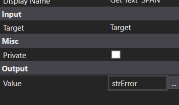

Also please check you have passed your strError variable in Get Text activity’s output property.

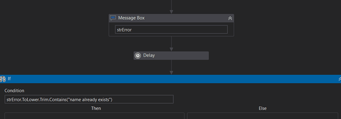

@shdacak…pls share the screenshot of your workflow.
Looks like you are trying to trim a null value. You get the object reference error when you try to trim a string which is actually null value.
Above the message box is the “Get Text” activity

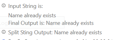

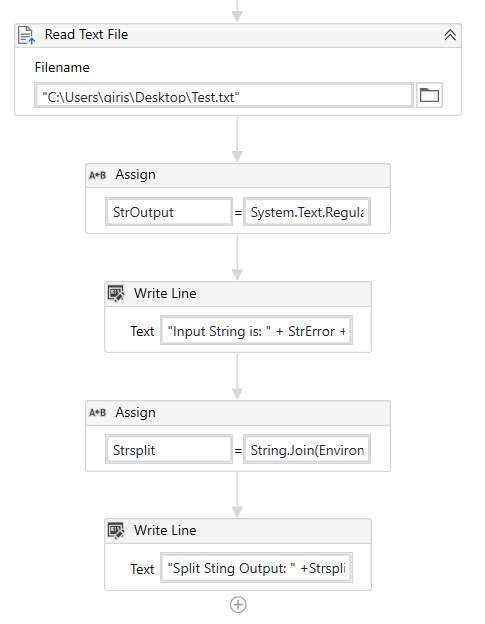

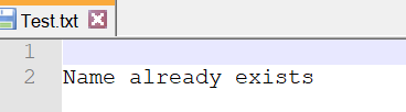

@shdacak - Since you already mentioned it is printing like this…
You can remove the new line by below two methods…1. Regex 2. String.Split
Output
if you wish you use Regex then :
Assign StrOutput = System.Text.RegularExpressions.Regex.Match(StrError,“(?<=\n).*”).Value
if you wish you use String.Split then :
Strsplit = String.Join(Environment.NewLine,StrError.Split({Environment.NewLine},StringSplitOptions.RemoveEmptyEntries))
My Input Text :slight_smile:
Hope this helps.
