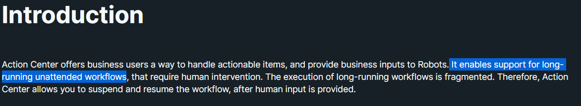

I’m not sure how an action center task would work with attended robots - probably the robot would just be busy and be unable to accept additional jobs until the task is completed. You should only use Action Center with Unattended Robots.
Action Center - Introduction (uipath.com)
Yes, this is true
