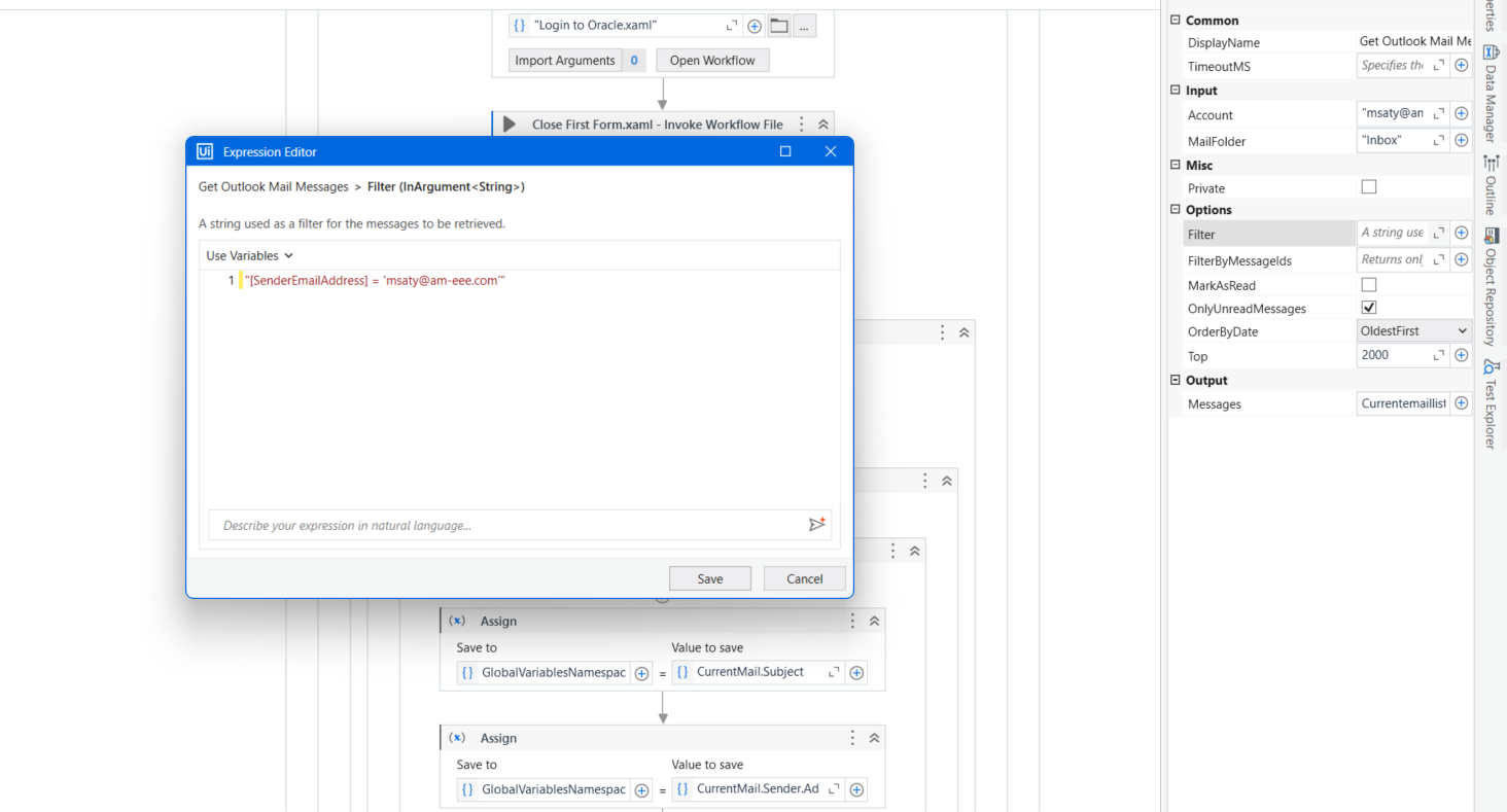

i have used get outlook message to read email account and then used for each to download attached files from all mails to be processed. but i need to download only the excel file. and ignore the other attachment using the filter at the get outlook activity. i have used this as filter “xlsx” didn’t work also i tried this “*.xlsx” also didn’t work.

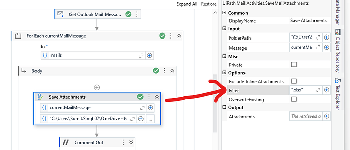

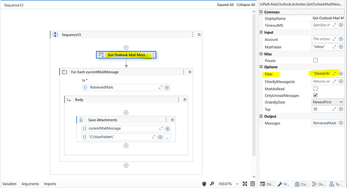

That’s a filter for the emails, not the attachments. Filter for emails would be like “subject eq ‘this is the subject’”
To get only certain attachments, you have to use the Save Email Attachments activity and set the filter there.

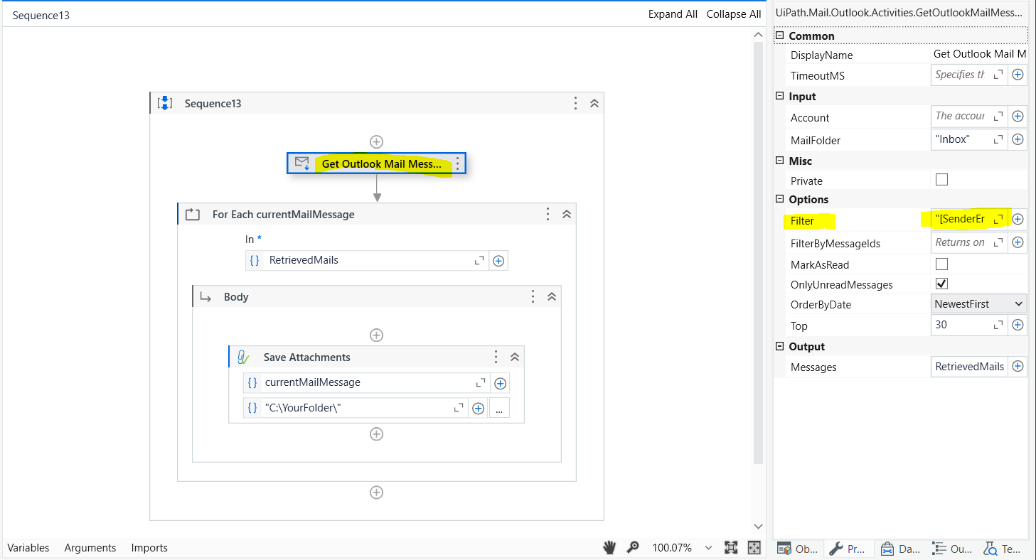

Hi @mohamed.saty2012
Can you try like below
@mohamed.saty2012

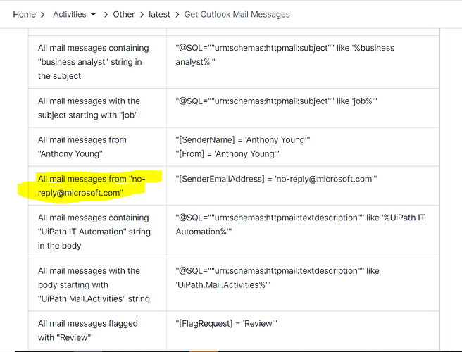

For only specific sender mails
"[SenderEmailAddress] = 'no-reply@microsoft.com'"
i have done the same for the senders but it didn’t work

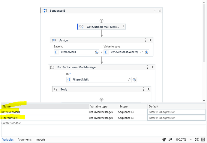

Another way try the below
FilteredMails = RetrievedMails.Where(Function(msg) msg.SenderEmailAddress.Equals("MailAddress")).ToList()
it doesn’t throw any errors the bot will process any unread email once i entered any value in the filter field it acts like there is no unread messages

I don’t understand your question. You are putting the filter into the Get Emails activity, that’s not where the filter should be. To get attachments you use the Save Attachments activity, and put the “*.xlsx” filter in THERE.
yes, I get that and I have done it the problem now in the get outlook filter i need to download the excel from specifics senders. the bot runs normally and process only the excel sheets but once I put in the outlook filter any email sender the boy ignores any unread emails.
if I remove the filter, it works fine

Have you tried another method which i have shared
can you share the assign value
@mohamed.saty2012
i will try and inform you
Hie @mohamed.saty2012 pass this filter in save attachment not in get outlook mail message actvity
this solve your query
