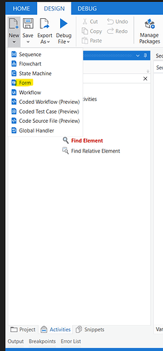

You can get the form workflow from the sequences when you click on on the New tab in design ribbon you can get that form workflow.
Hope it helps!!
