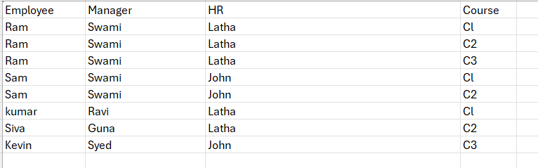

Hi, input is in form of excel file
Hi @Deeipauk
Can you share the screenshot of input excel file.
Regards

Hi @Deeipauk
Hoping this is the input excel
Use this invoke code

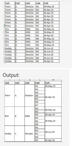

i added screenshot in my post, these fields from input file
Thanks sanjay, I created the test data as per columns I have, pls check below

html = "<table border=2><tr><td>" +
    String.Join("</td><td>", YourDT.Columns.Cast(Of System.Data.DataColumn).Select(Function(x) x.ColumnName).ToArray()) +
    "</td></tr>"
Dim grouped = From row In YourDT.AsEnumerable()
              Group row By
              Col1 = row("Col1").ToString().Trim(),
              Col2 = row("Col2").ToString().Trim(),
              Col3 = row("Col3").ToString().Trim()
              Into GroupRows = Group
              Select Col1, Col2, Col3, Items = GroupRows.Select(Function(r) New With {
                  Key .Col4 = r("Col4").ToString().Trim(),
                  Key .Col5 = r("Col5").ToString().Trim()
              }).ToList()
For Each g In grouped
    ' Group Col4 items by Col5 (date), so we can rowspan by date too
    Dim byDateGroup = g.Items.GroupBy(Function(x) x.Col5).ToList()
    For i As Integer = 0 To byDateGroup.Count - 1
        Dim dateGroup = byDateGroup(i)
        For j As Integer = 0 To dateGroup.Count() - 1
            html &= "<tr>"
            If i = 0 AndAlso j = 0 Then
                html &= "<td rowspan='" & g.Items.Count & "'>" & g.Col1 & "</td>" &
                        "<td rowspan='" & g.Items.Count & "'>" & g.Col2 & "</td>" &
                        "<td rowspan='" & g.Items.Count & "'>" & g.Col3 & "</td>"
            End If
            html &= "<td>" & dateGroup(j).Col4 & "</td>"
            If j = 0 Then
                html &= "<td rowspan='" & dateGroup.Count() & "'>" & dateGroup.Key & "</td>"
            End If
            html &= "</tr>"
        Next
    Next
Next
html &= "</table>"

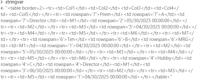

Output Stringvar :
Use this variable in the body of mail activity
Do mark it as a solution if it helps you :innocent:

Sanjay,
Geeting output as shown in picture,
1.Due date and MD column not grouping.
please check your logic.
Expecting to get below like this
