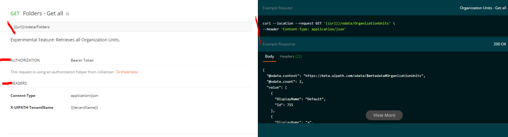

However, I can’t call the endpoint Folders. The documentation is awful. Here’s all informations I have about Folders to show you what I mean by “awful” :slight_smile:
I got the Folder call information here :
This is Folder doc in API doc :
Note that the URL is not the right one. And the authorization is marked SEPARATE from the header.
Moreover, it is not specified if the authorization is a JSON, nor the key, if it is a String, if it contains keywords, its format…
Then I search information by my-self :
https://docs.uipath.com/orchestrator/v0/reference/folders-requests
This is what I get, 2 end point that don’t correspond at all to what I’m looking for, nor to what the API doc shows. In addition, this time we have information about the authorization which is probably a String, remember well.

The reason why the Authorization is separate from the Headers is due to the fact that the documentation is generated from Postman, where the Authorization is indeed shown in a separate tab, even though during the request is being included in the Headers.

My last tip: in the Postman API documentation (that you show in a screenshot in your comment), change the language to Python, so you can see the code properly, BUT check the fields described on the left side (white part), not in the code example, since as you noticed, those aren’t correct (old version).
