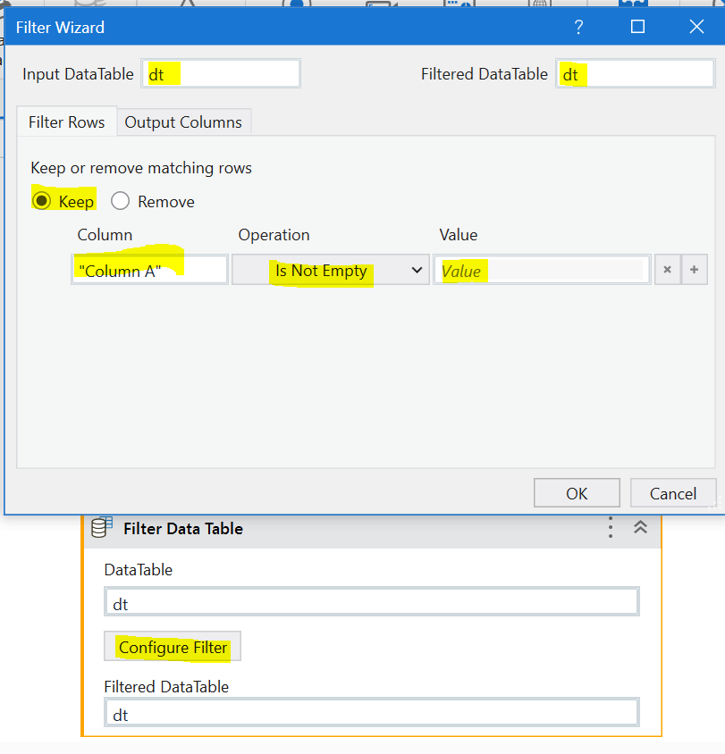

For filtering data in rows. You can use like below . Here the filtering is for rows where the column A is empty .Similarly you can change the condition for your requirement

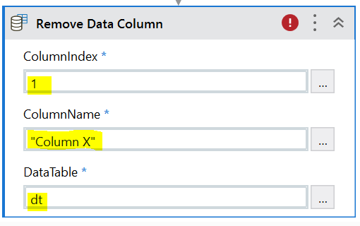

In the same activity if you already know which columns to remove, then give the column names like below and they will be removed
For removing or deleting column use as below… Here either give the column index or the column name to delete that column(Give only one of those two)

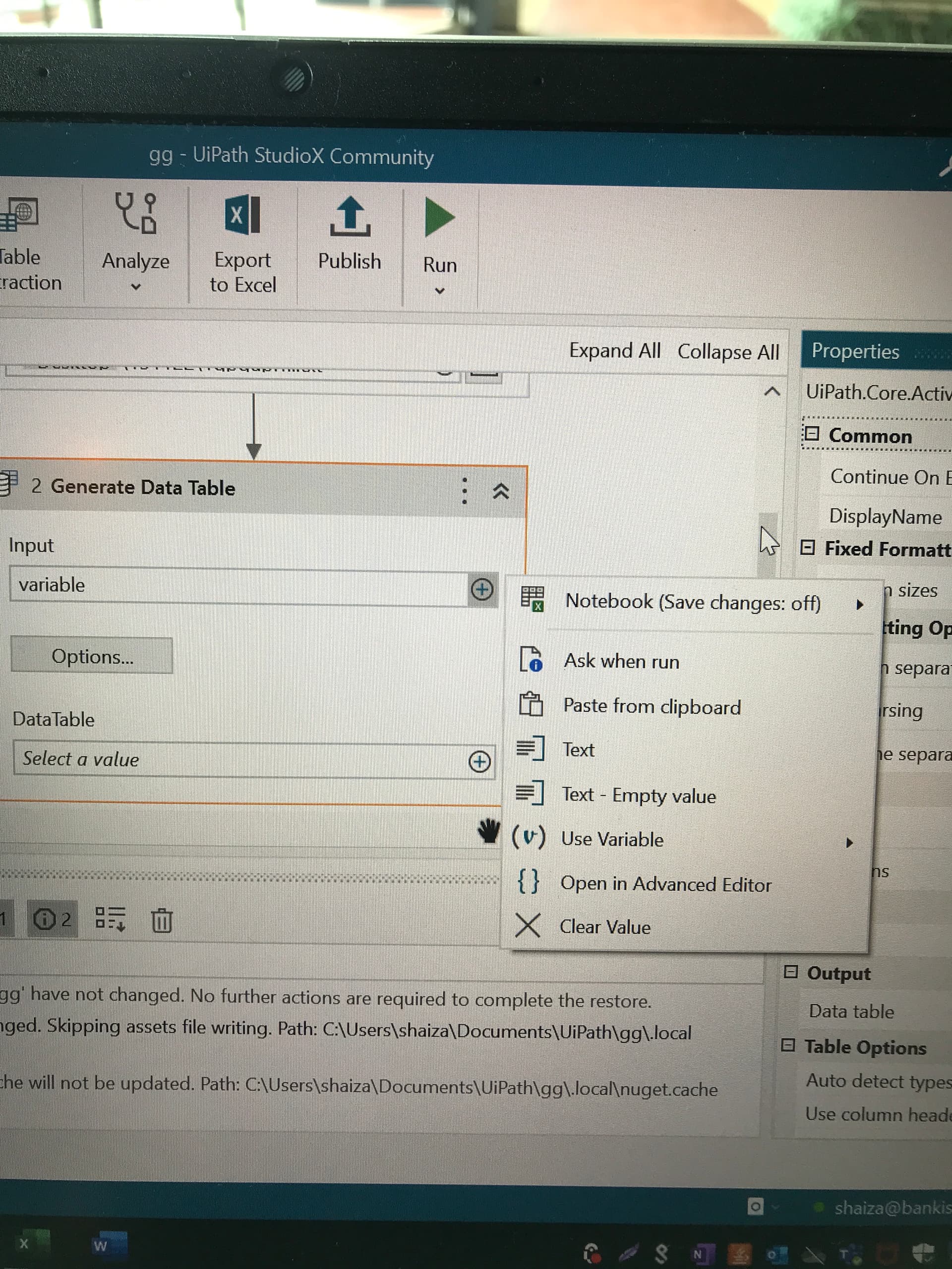

No that you are trying to write to file directly…Click on the output field…Delete everything like file(dt) etc and click ctrl+k then write a name…That name is the variable name for your datatable…Ctrl+k automatically creates a variable
cheers
Variable name for my datatable means i just simply name it or how? Because in the output, i need to choose
Hi @Nur_Amin
You dont need to choose…after clicking plus select advanced editor…press ctrl+k and give a name and press enter…a variable gets created… did you get a chance to complete your basic training from academy.uipath.com? If no i would suggest you to do that so that you will get a fair idea to move ahead

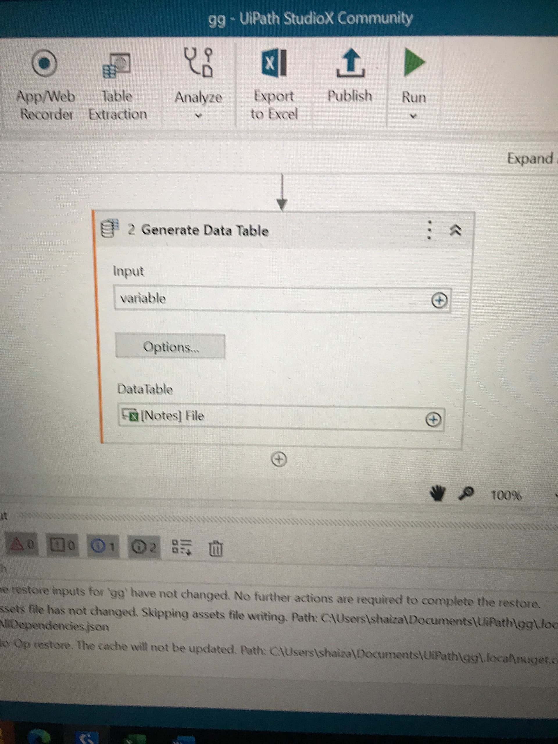

What i need to put here?
@Nur_Amin you have to put a datatable variable or create one using ctrl+k
How to put data table variable?
@Nur_Amin
What i need to choose in input as per image
@Nur_Amin
do this. After that you will see the variable when you click plus

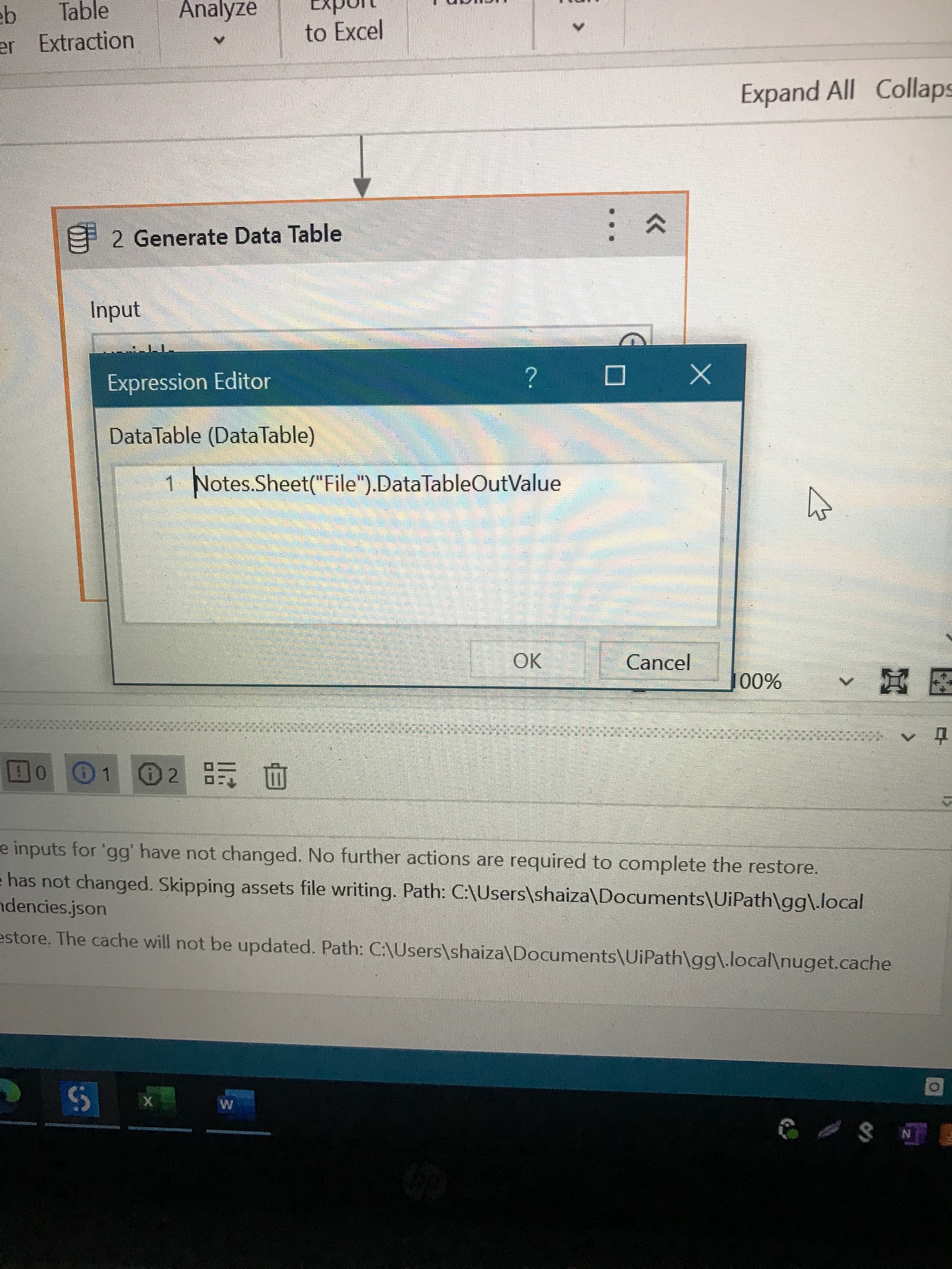

I need to do the variable first then generate data table? Or when i drag data table, i click button + then add the variable as u show above?
You have any idea for the problem?
Hi @Nur_Amin
It says the input that you provided is empty

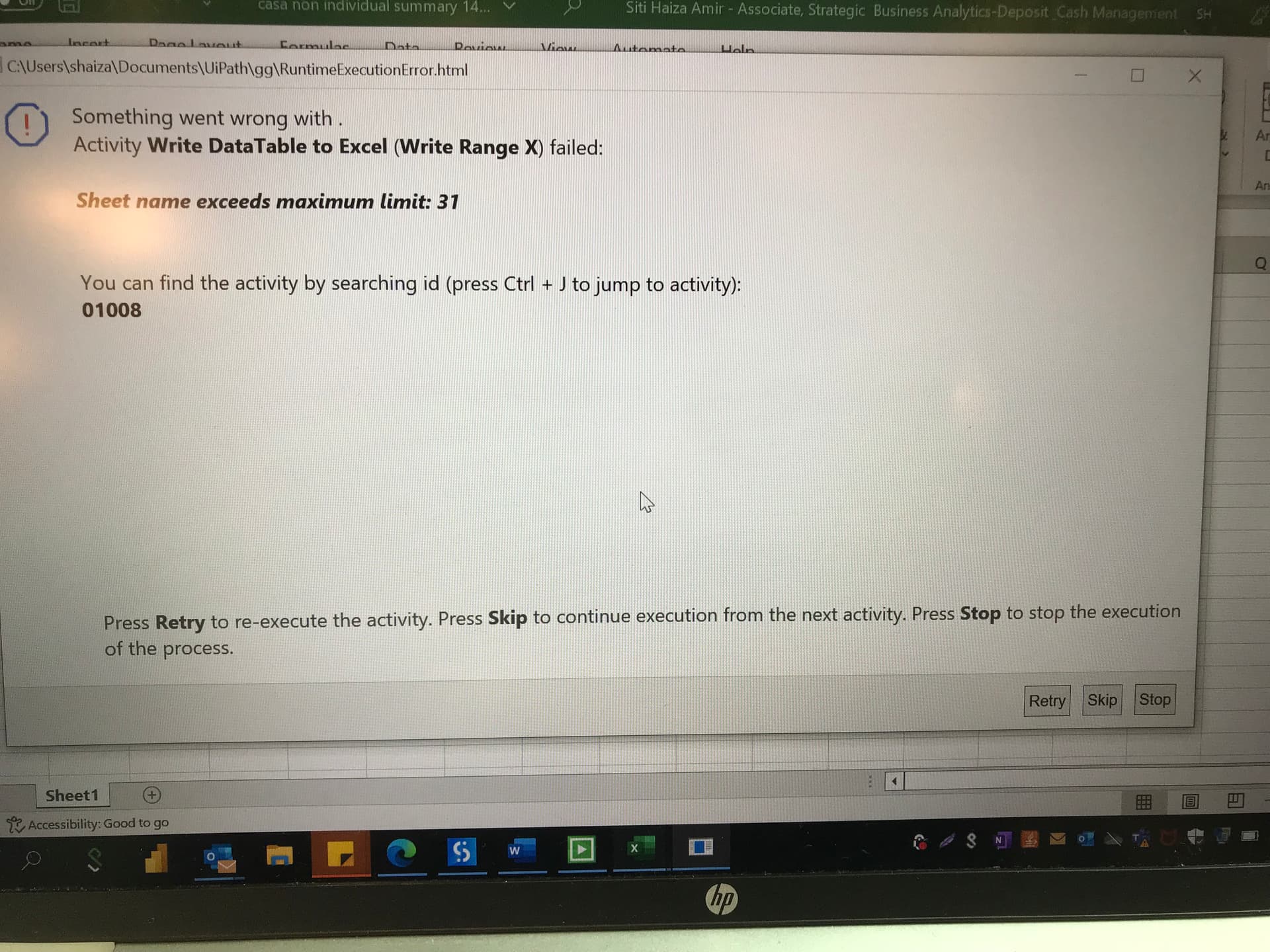

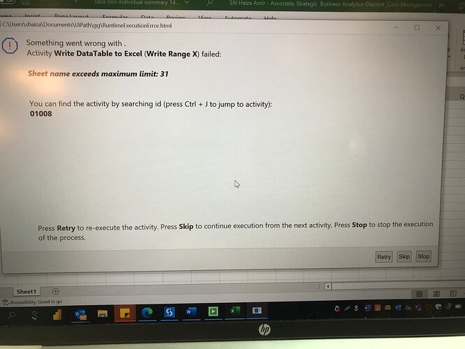

I have do some amendments, do u have any idea how to i correct this error?
HI @Nur_Amin
The sheetname that you provided looks more that 31 characters. Make it smaller and this error would stop
